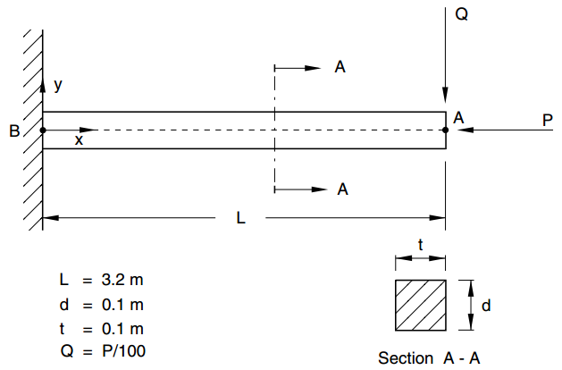

几何:
![](https://www.simapps.com/upload/file/20211231/9880f084-3f05-4a62-9c61-37d106cd80b6.png)
材料:
线弹性 E=2.1e11 Pa,v=0.0。
截面:
梁单元采用矩形截面,壳单元采用壳截面。
边界条件:
左端固支。
荷载:
点A受两个荷载,集中力P沿x轴负方向,集中力Q=0.1P沿y轴负方向。其中P*L^2/(EI)=22.493。
单元:
Hex20,Beam2,Shell4。

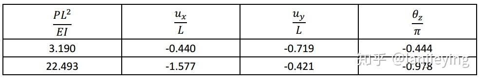

参考解
This is a test recommended by the National Agency for Finite Element Methods and Standards (U.K.): Test NL6 from NAFEMS publication NNB, Rev. 1, “NAFEMS Non-Linear Benchmarks,” October 1989.
点A的位移为:
![](https://www.simapps.com/upload/file/20211231/474279c3-3d8a-443a-9377-a3e2acc607af.jpg)

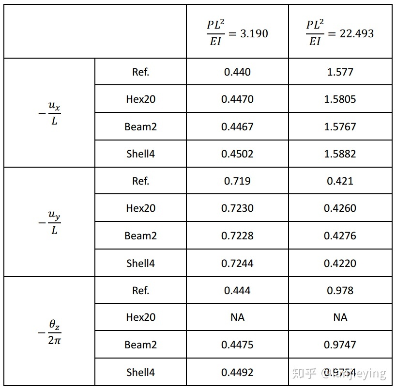

结果对比
计算结果如下表所示:
![](https://www.simapps.com/upload/file/20211231/c735601f-8395-4c00-9b73-77c81ecb5c3c.jpg)

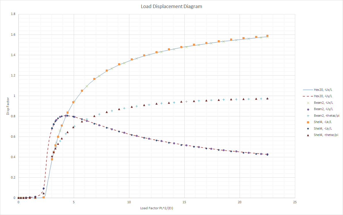

各个单元的荷载位移曲线为:
![](https://www.simapps.com/upload/file/20211231/c7adce9a-3d6e-487f-b414-f341e4bf665b.png)

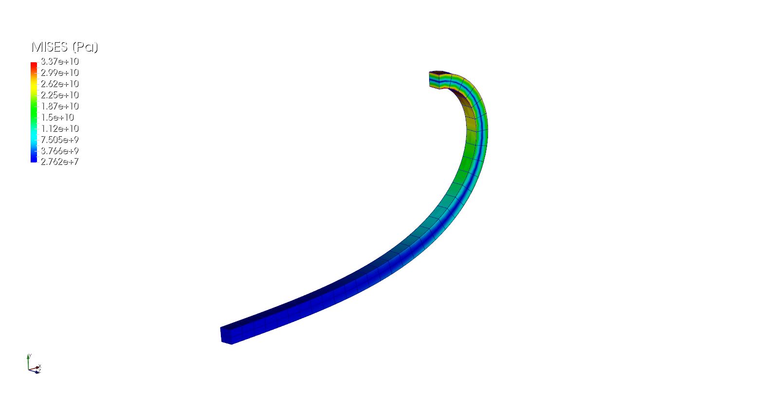

He20单元的等效应力云图为:
![](https://www.simapps.com/upload/file/20211231/29d14579-cbf5-483e-8ca7-f4c5a3a40a2b.jpg)

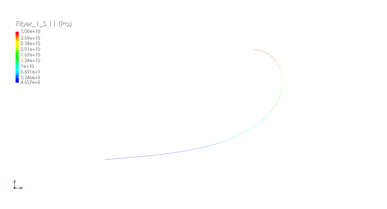

Beam2单元的轴向应力云图为:
![](https://www.simapps.com/upload/file/20211231/e5766532-9559-467c-bb5a-56290e1d18a4.png)
其中Fiber_1表示梁截面输出纤维第一层处的应力,为矩形截面的左下角;S11表示沿梁的局部坐标系的轴向应力。
结论
Simdroid的梁、壳和实体单元的几何大变形计算结果与NAFEMS结果相一致。
